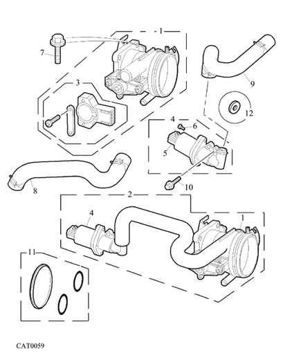

Resistor on the throtle body that controls idle revs and not letting it get on 800 immediately if you are going to give new higher revs on engine?
It well may be that this resistor is playing up and needs replacing...
Try to make a check of that resistor and see if it is the problem...
Part #3 is the one I am aiming to. Electric part of it can start playing up.
